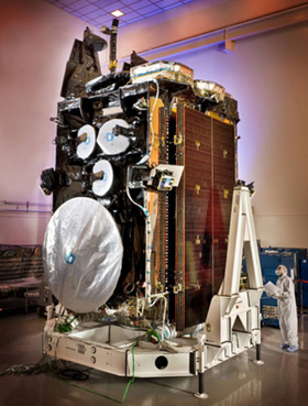

„Advanced Extremely High Frequency 1“ (AEHF-1) palydovas
